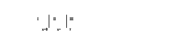

Consider the three-region slab configuration shown below.
The absorber region (Region II) extends from x=0 to x=t and is assumed to be a source-free region which scatters neutrons isotropically. Since the angular fluxes y(x,m) incident on Region II from Regions I and III must be continuous at the boundaries,

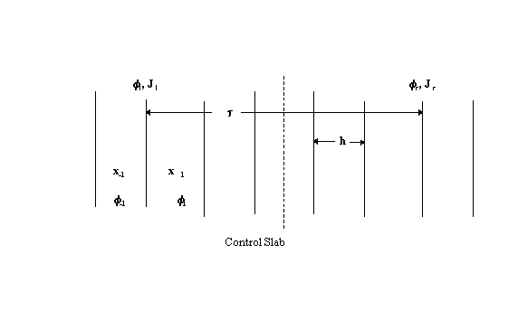

The effective diffusion parameters are chosen so as to preserve the current-to-flux ratios on the surfaces of the control slab as given by the blackness coefficients. Since these effective diffusion parameters are to be used in a finite difference solution of the diffusion equation, they contain an explicit dependence on the mesh interval size, h. This allows the use of a very coarse mesh in the absorber for diffusion calculations. Equations will be derived for the effective values of D and Sa for use in those diffusion codes, such as DIF3D4, which evaluate fluxes at the center of mesh intervals. The same methods may be used to determine the effective diffusion parameters for codes which evaluate fluxes on mesh interval boundaries. These techniques for determining mesh-dependent effective diffusion parameters as functions of a and b were first proposed by E. M. Gelbard.17
Consider the following diagram.
It is convenient to assume that the same material extends to regions outside the absorber slab of thickness t. Since a and b depend only on the properties inside the slab, this assumption leads to no loss in generality. If the flux varies linearly from the center to the edge of the mesh cell,
fl = (f-1 + f1)/2 and Jl = (D/h)(f-1 - f1) .
The solution to the diffusion equation within the source-free absorber consists of a symmetric (cosh kx) part and an asymmetric (sinh kx) part with respect to the centerline. For the symmetric solution, fl = fr , Jl = Jr , f1 = C cosh k(t - h)/2, and f-1 = C cosh k(t + h)/2 so that after some manipulation
Similarly, for the asymmetric solution, Jl = -Jr, fl = -fr, f1 = A sinh k(t - h)/2, f-1 = A sinh k(t + h)/2 so that
The ratio of these equations gives
from which it follows that
The expression for the effective diffusion coefficient is obtained by adding the equations for a and b.
